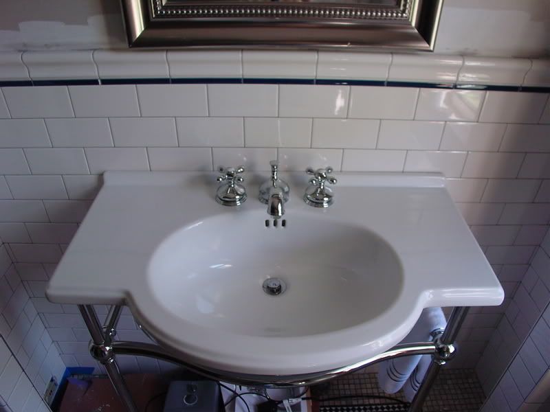

I would do it in a heartbeat for a half-bath, but for our everyday main bath we went with a new serpentine console sink with a widespread faucet. It looks classic, though not as "authentic" as some fuller ball single taps. :)
Another consideration is that over the years the use of a bathroom sink has changed somewhat. Lots of people used to wash their hair in sinks before daily showers were popular, so you might notice that vintage sinks have a much lower height. Often about 30" tall, I have found our sink set around 35" is more comfortable to use on a daily basis.
