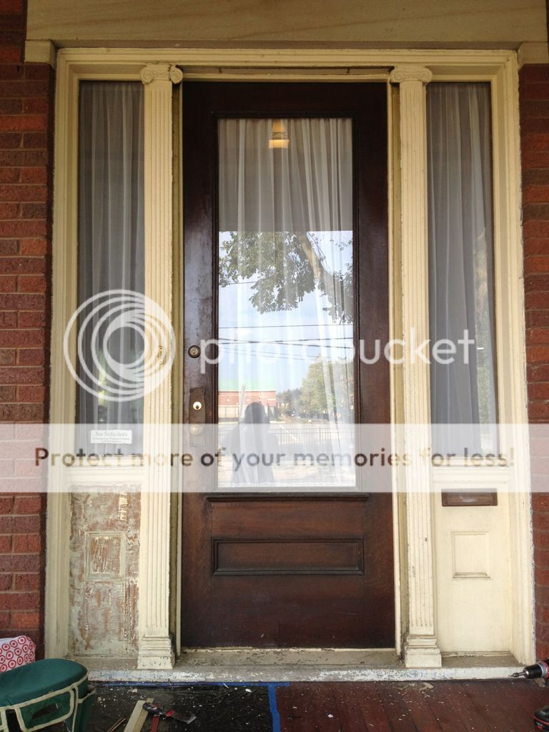

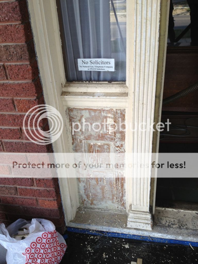

And here's a test area my wife did. She left it on for 24 hours and covered it with Saran wrap.
I took off the security storm door. This was put on by a drug dealer who lived here in the 80's. It weighed at least 100 lbs. It will be on craigslist tonight.

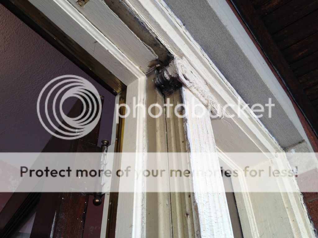

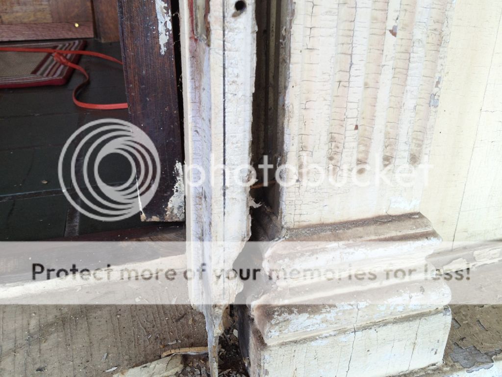

And the details of the door. The sides of the columns were fluted as well
The top of the left column broke off and was being held in by the storm frame. I'll glue it in and fill in the damage to look nice.

wow, that was some scribing job they did on the storm door extender piece....nice entrance way!
so, what do you think of the smart strip? did it work as well or not as well as you had hoped? it looks good to me...you've got some work ahead of you but it will look fantastic once all is said and done and the last coat of finish paint has dried...
great work....
