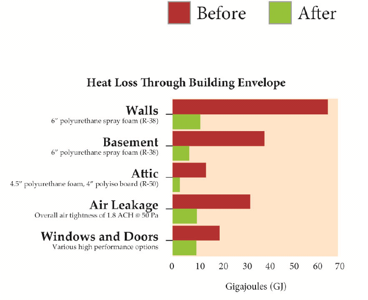

PS: a case study on a brick house very similar to ours indicates that heat loss through the walls is the single biggest source of overall heat loss, so it seems beyond doubt that this is worth considering if it can be done without causing structural damage:
