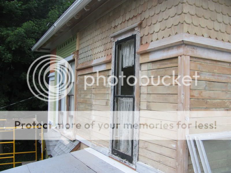

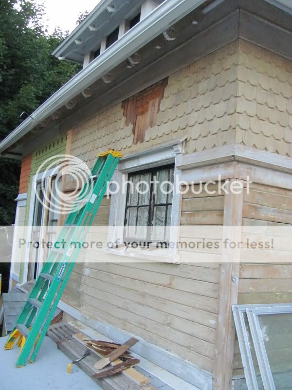

started painting about a week ago...but more important was getting rid of a window that was installed after the fire about 1928-29... i don't know what the heck they were thinking there were no other windows in the entire house that looked like this and it has bugged me for the 4.5 years that we owned the house. my neighbor gave us a window, frame and storm. its one inch narrower than the original but the height is perfect. Because i have never done anything like this, our buddy greg came over to help install..actually he installed it...i played gopher... it took two days and the sashes still have to go in but right now the storm will suffice.
i was just removing the shingles last friday to be ready for saturday.
hole cut and framing left to do.

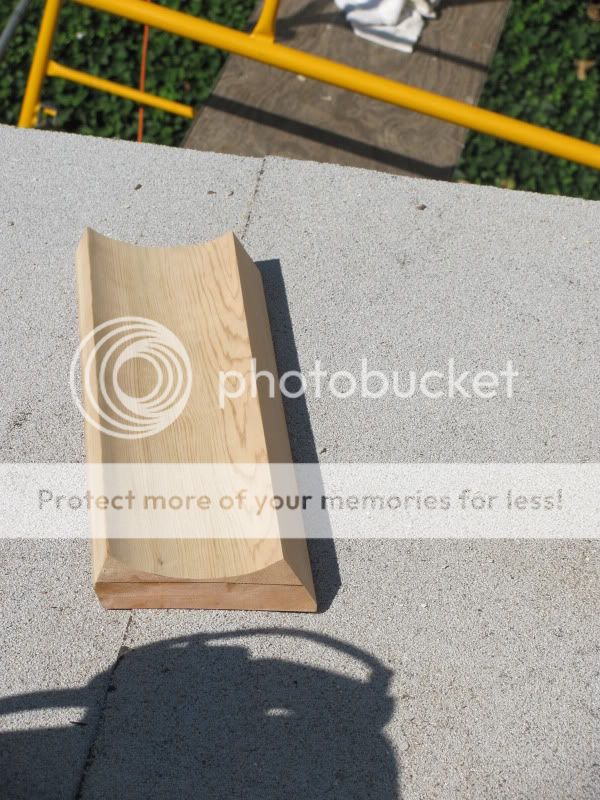

because the new old salvaged window is narrower that the 1928 window, molding that separated the shingles from the tongue in groove had to be reproduced to fill in the 9 to 10 inches on either side of the new window. greg had an idea to reproduce the concave molding and it matched perfectly...took him a while but he got it.

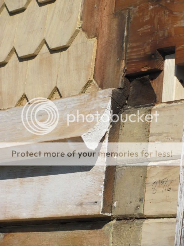

where the old molding stopped..you get a good view on how it was attached...
one of the reproduced piece

all done....took 84 years but she is back how she use to look...now on to priming and painting...

1880 stick - that's quite a project you have. Nice work on replacing the window, looks like its always been there. I remember Norm on the new Yankee workshop making a molding like that. He clamped a few boards on his table saw as guides and ran the board thru at an angle at the blade and moved the blade up a bit each pass. He used the radius of the blade and the angle of the pass to get his concave curve.
