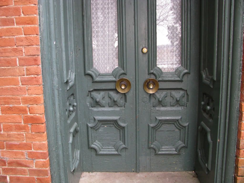

Front door before
Front door after
In the near future I'll locate and install a period eastlake door set in it's original position about 6 inches lower that he current 1964 set.

Alexander, yes on the windows and no on the door. The windows and the eaves were originally that colour,and the door and the door suround was stained. I used the SW paint restoration site to match the colours. My plan is to paint the eaves the same as the windows, that was the original paint scheme. SW calls it rock wood red and use the rockwood dark Green (the door colour)for the brick mold. When I get to replacing the king and queen posts and the verge boards my plan is to deviate and go to the the Downing slate for that. If I decide to go with a forth colour it will be the Downing straw that the SW swatch suggests to pick out the details.
If you have a good eye you might just find a piece of the original paint on this little test sample and a hint of it left on the eave.

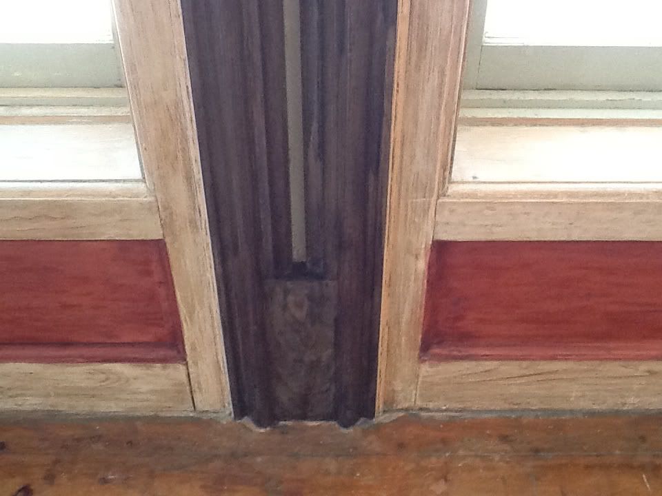

Well it's been a while since I last posted update pics so here is my progress on the bed room at the start of the topic.
Here is a close up of the staining, the stain I used was Minwax form the local HD. The red is Sedona red right out of the can. It took three coats to get the shading close to original. The dark chocolate is a 50/50 mix of dark chestnut and ebony. The colour I's not a dense as the original stain but we are happy with it. It's not as dark as the original
