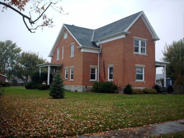

Just finished with a new asphalt roof. Here's how I arrived at my choice. The original roof was cedar shake in 1908. Asphalt was placed over the cedar shake in 1948, cost $585. Another layer was put on in 1972, cost $1547. It was my great-aunt's house so I have all the receipts.
The 6 estimates for tear-off, new decking, felt paper, valleys, flashing, ridge vents, and 30 year architectural-style shingles ranged from $6000 to $19000. I threw out the high and low and the four remaining were all around $11000. I checked with the BBB for any complaints. I met with each estimator to make sure that we were on the same page as to what had to be done, basicaly crossing all the "T's" and dotting all the "I's". I then got a list of 6 completed projects from each company and called the customers for their opinions.
All of the companies received good reviews so I asked each of them if they'de do the job for $9500. Two of them said they would and we chose the one who had done extensive roof restoration on several area historic homes, churches, and county courthouses.
Regarding the metal roofing question; one of the roofers in the $11000 range quoted $12000 for a standing seam roof put right over our (3) existing roofs. The guy who did our roof also said he would do metal over existing for about the same price as our eventual tear-off & replacement.
Here's our home before the roof replacement. I'll have new pics this week-end.
Greg
Greg
