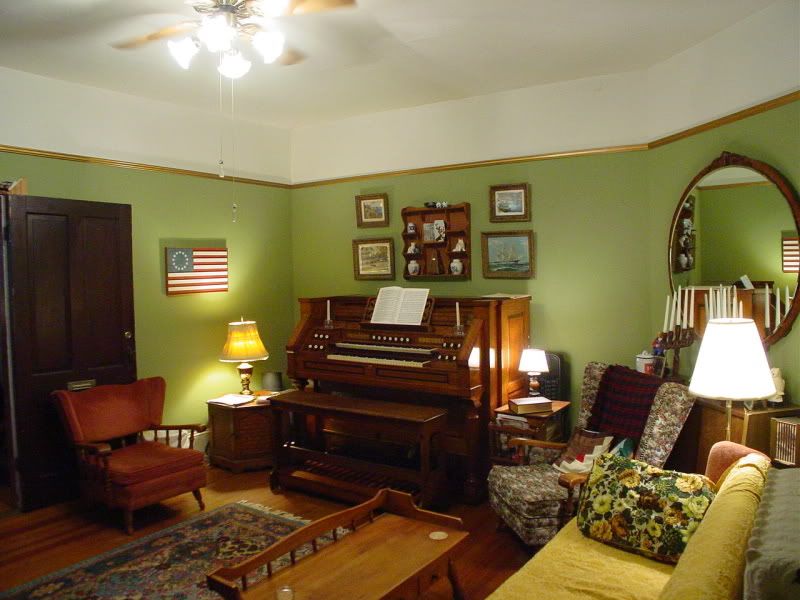

This is a crappy photo that doesn't show you the door, but I believe our windows are also taller than our doors, and our picture rails run level with the tops of the doors and - as you can see here - the top of the actual glass part of the window rather than the window frame. I can try to get some better shots if that would be helpful.

I have ceilings about 9' 9", so I ran all new picture mold at the 8' line. IMO it breaks up the wall area just right. I painted the ceiling color above the pic mold.

the picture rail looks great at that height as so all the wonderful keyboard instruments. Love them!
