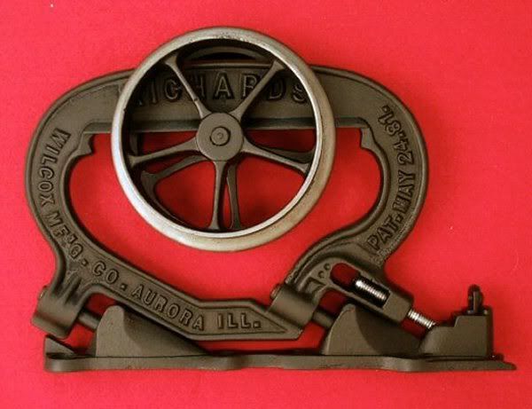

Here`s an illustration of the wilcox rollers in my house. At the edge of the door the mechanism has a little metal door that slides up and the adjustment screw is underneath to rais or lower the door. These rollers are very quiet when working prooperly. Over time our headers had sagged in the middle and all the adjustment had been used up so I had to remove the doors and cut a 1/4" off the top of the door. The wheels are pressed on but not really tight so getting a small pry bar in the jamb I was able to get the wheels off the axel then realease the stops on the door slide it oud into the opening and swing the bottomout untill the door comes out at the top. It`s been one of the most frustrating jobs but I am very proud of them now. :D
