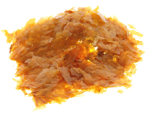

You can buy ready-mixed shellac at most hardware and paint stores.  Make sure it’s not past the expiration date printed on the can.  I use this kind for woodwork and mid-level antiques.  If I’m working on something special, I’ll mix my own from flakes and alcohol.  It dries faster and harder that the off-the-shelf type, but it costs more and takes time to prepare.  You can also tint shellac with aniline (spirit) dyes. This is an excellent method of matching new wood to an old finish. Shellac also comes in white (aka clear, blond or bleached) shellac, but I find it’s not as rich looking.  There are also darker grades of shellac flakes, such as brown or button lac, but typically, only the would-be furniture conservator gets involved with these.
