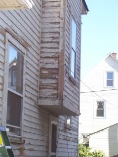

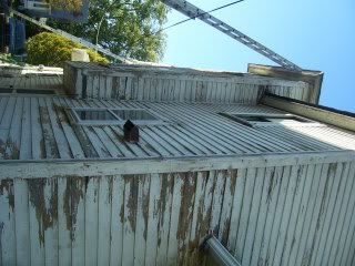

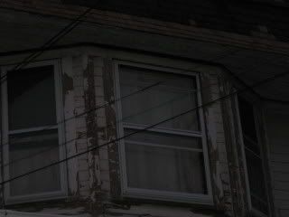

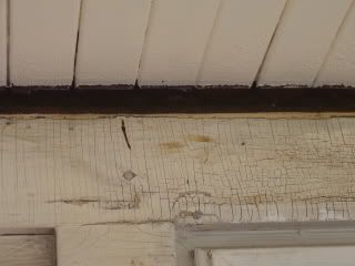

The damage has been assessed. We need to replace about 30 LF of cedar clapboard siding, 35 sf of cedar shingle siding. We need to sister in sills on 26 windows and place crown molding on 22 of them, as the aluminum installers also hacked off some of the top trim on several windows. We also need to replace the crown on both porches. Lucky for us we did find that crown molding on ebay.

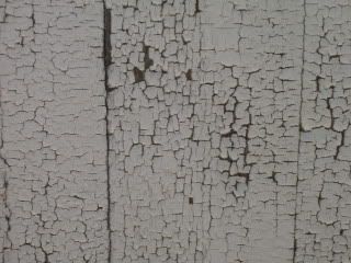

Sombreuil_Mongrel wrote:I am "in process" on removing the aluminium. The siding underneath was in good shape, but the old paint started peeling off immediately. It needed lots of prep. The back porch area had been half-enclosed in 1938. Maybe next year I'll set up pump jacks and finish a side.

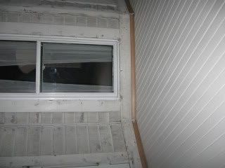

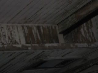

Free at last....
Updated pics
back porch ceiling
Updated pics
back porch ceiling

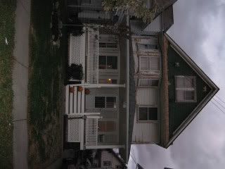

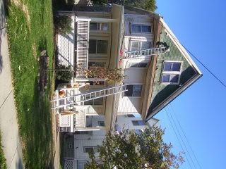

The next two days are going to be cold and windy, rain tonight and I am missing half my roof, the detailed trim that I have on the rear of the house has been removed from the front. I am going to ask the contractor to move the rear gable trim to the front gable. He is not going to be happy, he is going to list 5 reasons why we shouldn't then 10 things that could go wrong. I am going to think positive. In keeping positive I went to sherwin williams site to get a mock up of the 'after' picture.
Here it is (only older and a few more accents):

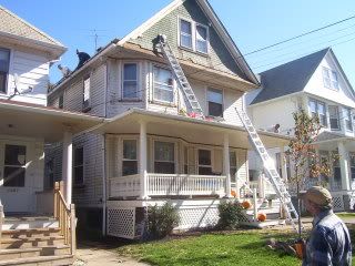

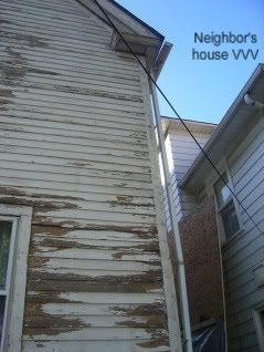

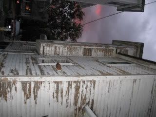

Pics from this evening (my new camera arrived at 6 pm)
Tomorrow the house will be washed. I thought it wouldn't be so bad for the house to look like this on Halloween but it will be primed on Friday and painted Sun-Wed. Looks like my grass won't be coming in.

Well the whole thing was supposed to be 10 days total. I was kindly warned here that would not be the case. The siding and scraping took longer than contractor had estimated (we should have known, it took us 2 yrs to strip the porch) add to that the repairs that were not included in the timeline and a few weather delays. He says 5, I will expect 10...might turn out better than expected. We also still have half of a roof to tear off plus the front porch roof. They can't do that after the house has been washed. Oh goodness!!!
It snowed here tonight but there is a warm front coming our way. I am going to keep my hopes up that the entire house will be painted by the middle of November.
