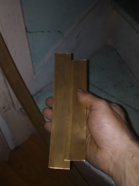

Corner treatment: Lay the top in first, then cut the end of the side strip at an angle to meet the top. Keep the strip far enough from the stop that it doesn't rub up against it. Then tack the nails in a little over an inch apart (I went with a spacing similar to the old spring-bronze I found in the front door frame.) Nails must be kept in the middle of the flat margin to keep the sprung profile of the strip to stay up. Contrary to popular belief, it is not at all necessary to pre-drill any holes in the strip or the doorframe, our ancestors certainly didn't do this. Ripping out remnants of the original spring-bronze on my front door frame and examining the nail holes seems to support this. Just keep the nails far enough apart and away from the reveal to avoid splitting the wood. Use nails of the proper size, made of copper, to avoid electrolytic corrosion.
To make the strip hug the hinges, give them a tap at the top and bottom of the mortise. You can caulk behind the hinge to minimize air movement further.
Better to cut a little long and lose a few inches here and there than to cut short and have to splice a piece in later.

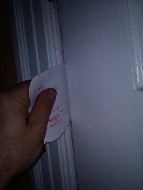

Test the fit of the installed stripping by laying in a piece of paper against the stop and shutting the door. You should feel some resistance as you pull it out.

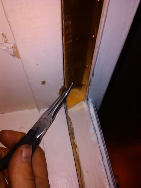

If the stripping isn't contacting the door, you can pry it back out with some pliers. Be careful not to make any creases that will allow air to escape.
